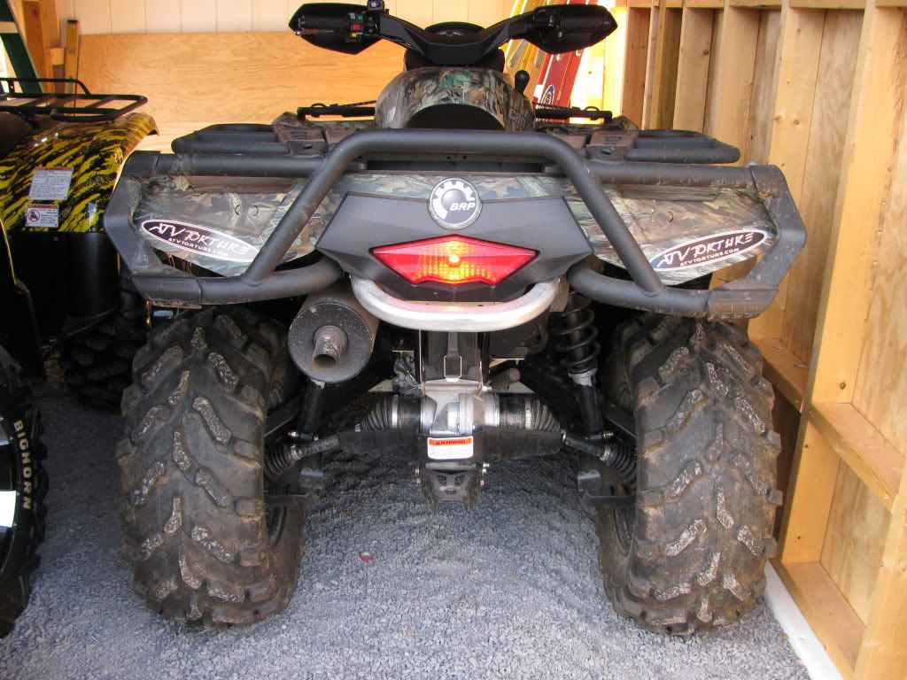

I'm stumped...what wheels are those Bandit?
If I told you I would have to kill you. :boxing1:
I looked for ever to find some wheels that i have never seen before. It just seems like if you have a 700 Grizzly you must buy ITP Wheels. ITP's are bada$$ but i just wanted to be different. So i found these and they are called Super Grip 5 spokes.
Excellent. I like them. I'm with you though...I have ITP's and I'm looking forward to something different!
Like those Super Grip Wheels. Price is good to. Nebraska Tire sels them if I remeber correctly.
I thought the same thing bandit, and likewise wanted to get different wheels, but the other brands are just expensive. Those wheels look really good as well as the tires. Great selection.
