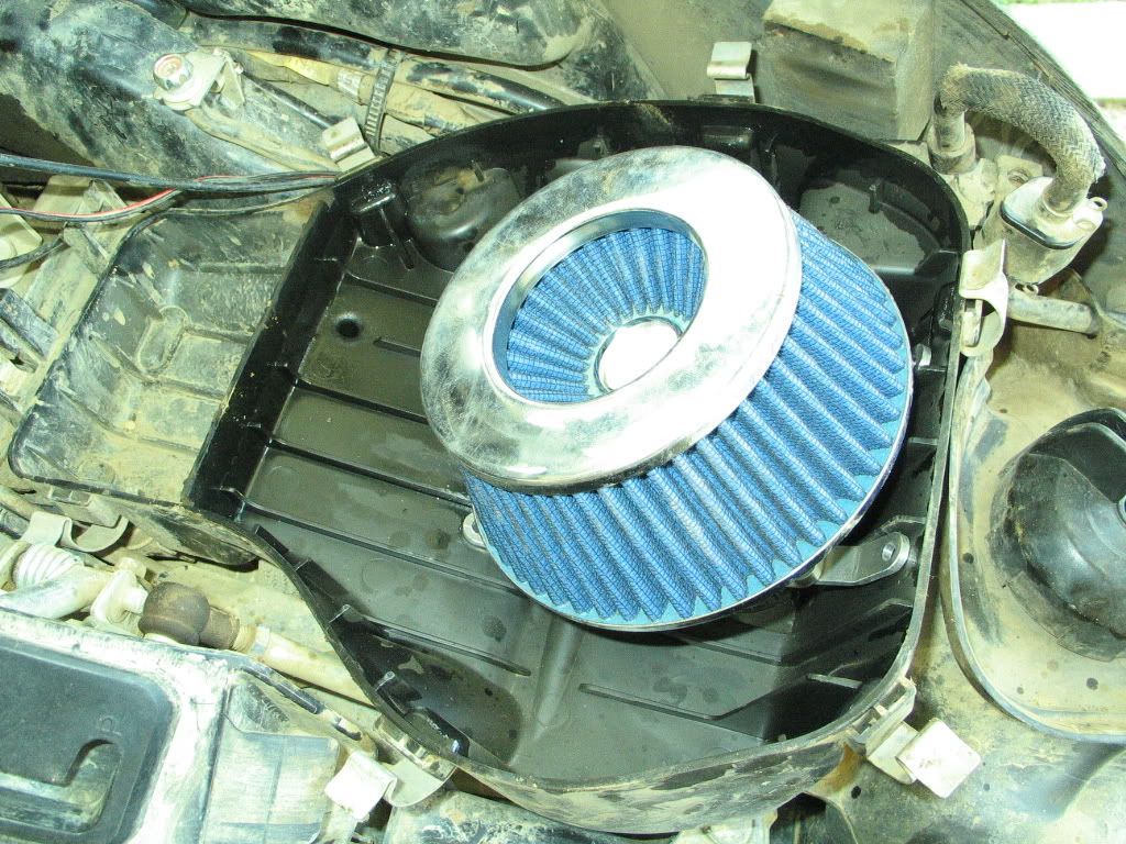

Just finished some preliminary testing of a new filter setup from <a href="http://www.ehsracing.com">EHS racing</a>. The system so far seems to be a great alternative to the substandard air filter setup that the Yamaha Grizzly 700 currently has. Some Quick math indicates that there is actually a little more surface area of air filtration than the stock setup. Overall results are still pending as this setup is in the prototype stage still. But like all of Eric's products it is top notch and seems to produce more HP.
Here are some pictures to tease you with.

Yikes, couple of concerns of mine.
I'm sure fitment and filtration at the intake point are top notch, but there's a few things that concern me. One is noise. That's gotta be real loud. Second is the open intake port. I forget which one this but I do know it sucks air in. I believe it goes to the top of the cylinder head.
Very valid point Koko! However I had discovered this during initial testing. I cannot get into how the re-design is compensating for this but it is being dealt with.
Excellent. Can't wait to see the new design. :cheer:
