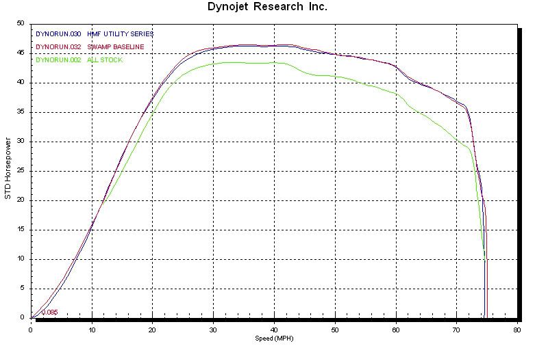

Here are some number straight from the HMF site (might have to click the image to read it). Probably not much help, but I found these to be interesting. And for the record, I'd love to pipe my quad, but one thing at a time.
