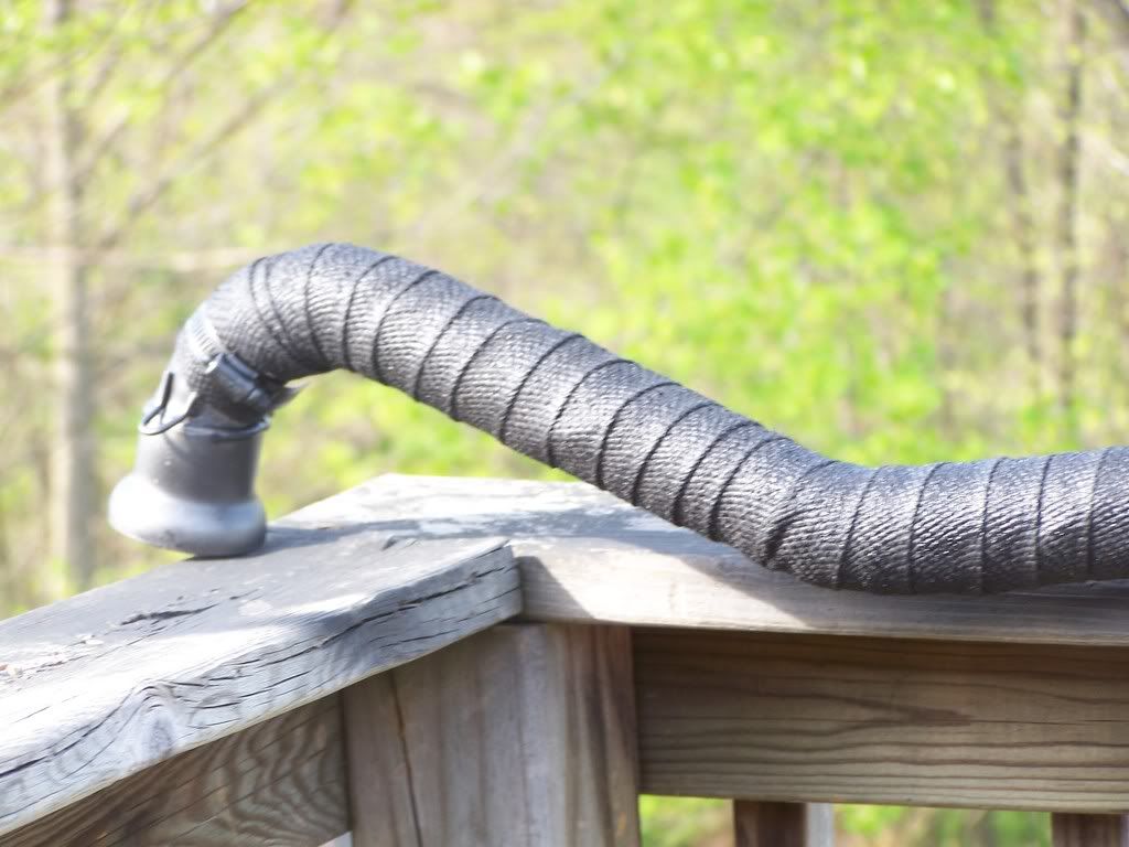

Not too many days after we bought our new turd ( I mean 07' Polaris 450 Sportsman) the plasitc melted right under the seat. I called the dealer where we bought it ( I won't mention any names) Polaris of Ripley Wv!!!! They said it was too bad and they were sorry. Today I called Polaris myself and in e few short weeks my new plastic should be here :bs: . Did I mention that the rear brakes went out as well, just 3 days after the 6 month waranty was up. I got told the same thing again by the place I won't mention( POLARIS OF RIPLEY WV) they were sorry but it was out of warranty. To make a long story a little shorter Polaris is going to fix the plastic but won't budge on the master cylinder. To keep this from hapening again with the melting plastic I wrapped the new header pipe with Cool It Thermo Tec wrap. Here are some pics of this mod I hope will keep the heat down.

With the combo of the wrap and special spray paint for wrap is suposed to reduce heat by 70% and create more ponies. The label said was good for 2000 degrees F. We will see

I can say that heat wrap makes a huge difference on both the bikes. We wrapped both the polaris and the grizz and still have plenty of wrap and spray leftover. We went on a ride for about 8 hrs yesterday and we never felt the heat like we did before..I won't replace the heat shroud on the grizz, and the polaris will get new plastic from the factory at their expense.

Not only will the heat wrap keep the radiant heat down , it will also slightly increase performance by allowing the insulation effect of the exhaust pipe maintain higher temperatures thus exhaust gases flow more efficiently. OK enough of the lesson in thermal dynamics.
Cool!
BTW did you happen to to get us any step by step installation information????

I just wraped my exhaust a couple weeks ago, and immediatly noticed no excess heat on my left leg.
Did you use the same stuff Bear Humper used?
I have used Thermo tec wrap in the past, but this time around I used DEI(Design Engineering Inc). Not that I reliesed it at the time, but the DEI wrap has colored threads in it @1/4" from the edge and it did come in handy for getting a consistant wrap. I didnt spray paint it like I should. And will probably regret not doing so.
