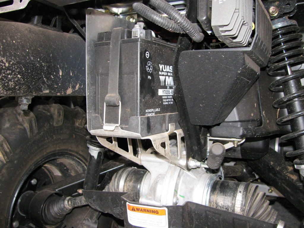

As far as the battery housing goes; I hadn't given it too much thought until this thread started. I went and examined this and found that the battery was not loose, and it doesn't seem as if it would be easily shifted. At least so much that the terminals would touch metal. HOWEVER, It is pretty wide open. Seems to me that the battery is pretty much just sittin there waitin on a rock to bust it. Additionally, the rubber strap and base plate don't give me a warm and fuzzy. Check out the picture.

i wonder if you could substitute the rubber strap with the metal hanger and battery retainer from a renegade? i had to add a few washers to mine, since the threads weren't long enough to keep it as tight as i wanted.
That is actually worth looking into. If the dealership weren't so far away I'd visit them to look at the Gade's battery set-up. I will probably end up doing a home made mod unless the Gade set-up is easy and inexpensive.
269 Posts
the basic setup looks identical from your picture. the only part i'm not sure about would be the hold-down on top of the battery. it's a piece of flat metal on the renegade, that "hooks" into the bike (at the front side of the battery). then, you have the metal rod that runs vertically at the rear, securing the top hold-down.
