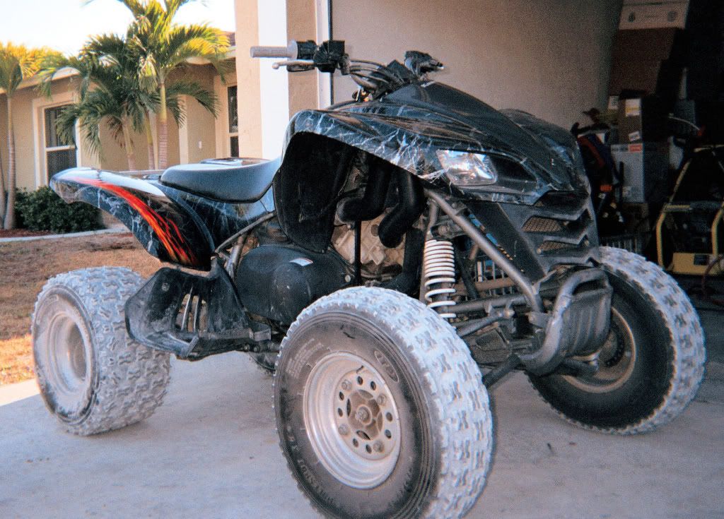

Whats up everyone i am new to this site and to the KFX 700 here is a pic and a few upgrades i have done myself ;;s;; Mooseracing Digital ignition, HMF Ex-pipe, FMF Jet kit Frunt [124] Rear [128] , K&N Air Filter.... I am new to the KFX 700 V-Motor so if there is any tips on things i can do to upgrade it or inprove im listening. Thanks
