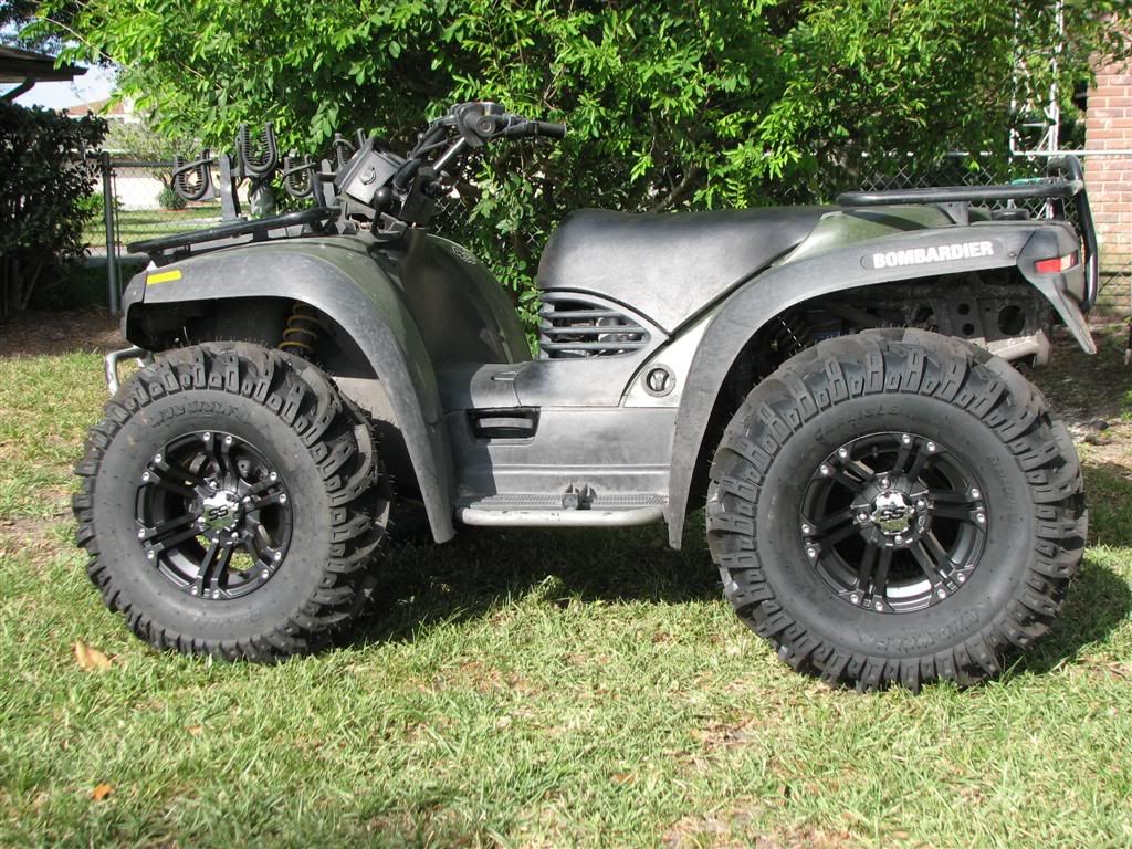

I went with the Mudwolfs and SS212s in black. A quick trip around the block and they seemed to ride smooth on pavement. Hopefully I'll be able to get into the woods this weekend. Here are some pics...
5
Man! Those meats look like they'll rip through the worst of it! Looks good Nacho. Let us know what you think of those meats.
;;t;;
They look great. Very wide! Be prepared to get muddy! You're the first one I've seen with the new wheels from ITP!
